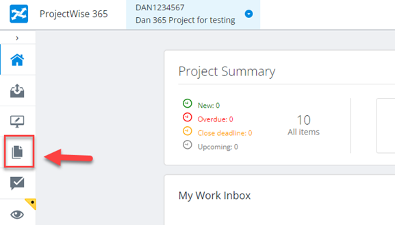

- Log into your Projectwise 365 connected projects at https://projectwise365.bentley.com

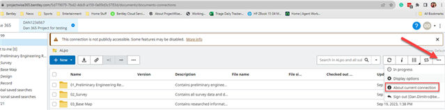

- Navigate to your connected Work Area Connection documents

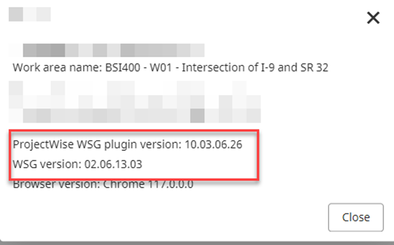

- Click on the 3 Dots to access the context menu for the Work Area Connection and choose “About Current Connection” .
- Your connection information will pop up in a dialog box.
