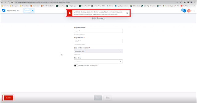

When trying to delete a project on the ProjectWise 365 portal, the following error appears,
Unable to Delete project. You do not have sufficient permission to delete project. Please contact your organization or project administrator.

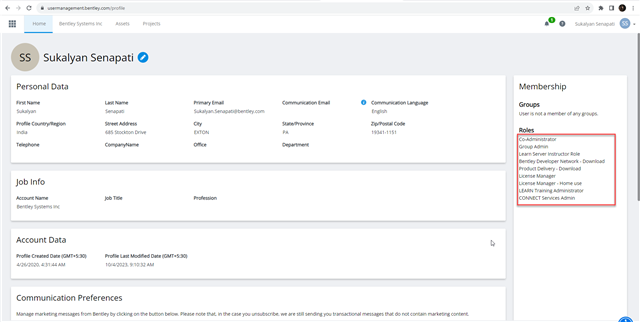

To check the permissions assigned to your user account on the User Management portal, please follow the steps given below-
  1. Open the link, https://usermanagement.bentley.com/profile. The available roles should be listed towards the right-hand side of the screen as shown in the screenshot below,

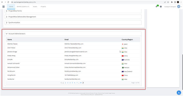

  2. Scroll down the page to view the Account Administrators of your organization. These Account Administrators can modify the roles of other users in the organization.

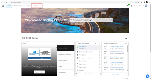

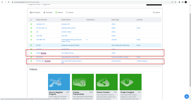

  1. Open connect.bentley.com and click on Projects.
  2. Projects which do not belong to your organization will have EXTERNAL tagged against them.
In such cases, if you have access to Manage Members on the project, you can remove your account from the project so you will no longer see the project. Alternatively, you can ask the project owner or a project administrator to remove your account from the project.
