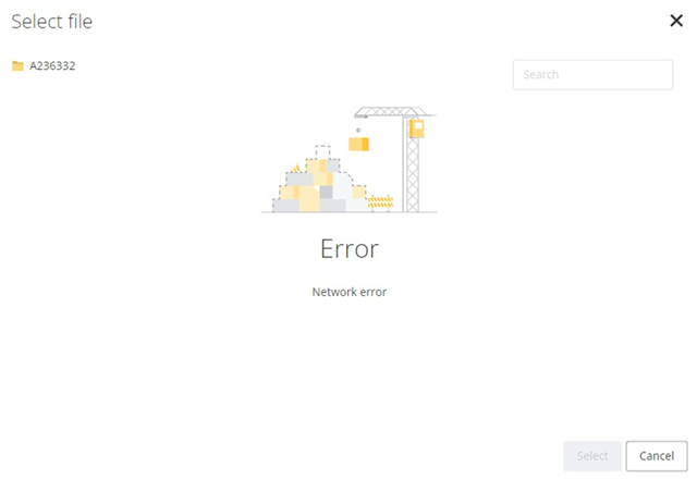

However, while adding documents to new transmittal from Projectwise repository “Network Error” is displayed.
Steps to reproduce issue:
·        Open Projectwise 365 portal. Click on add new Transmittal.
·        Go to Documents Tab and click on 'Add new Document'.
·        “Network Error” displayed.
For ProjectWise Web integration with the ProjectWise Deliverables Management portal, the administrator will have to modify the Bentley Web Services Gateway deployment used by ProjectWise Web to allow cross-origin resource sharing (CORS) requests coming from the following additional service
URLs (each of the URLs below must be added to the CORS list, separated by a comma, either using the Bentley Web Services Gateway deployment wizard, or by manually editing the web.config file):
