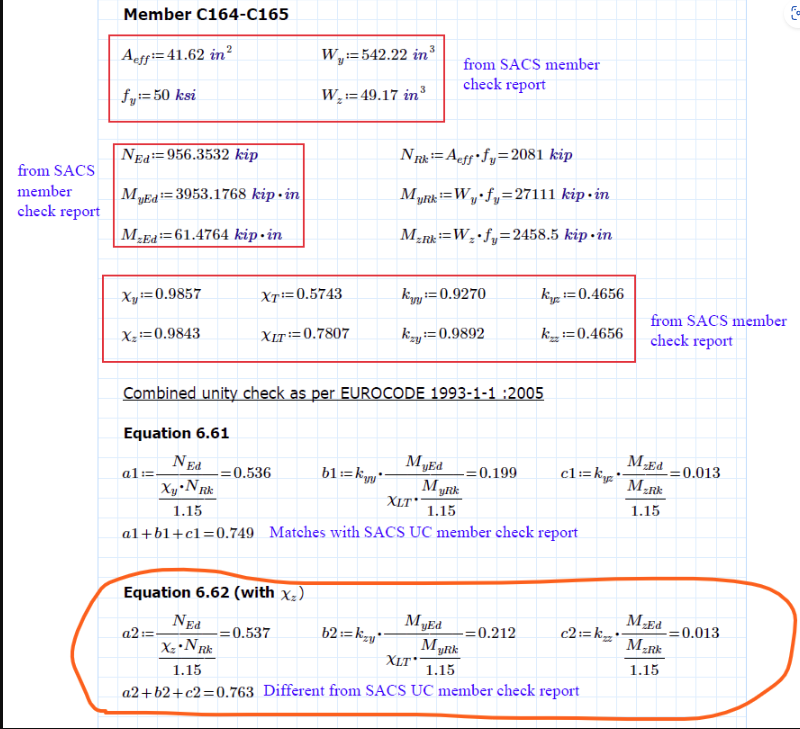

Hello Bentley, I would like to know how is calculated the combined unity check using Eurocode, I'm trying to track how is calculated the second Uc report by sacs, but I wasn't able to figure out how is getting, somebody could you explain this please?
Answer:
for the calculation of a2 SACS assess and take the lower value of X_z ot Tt and apply this one in the calculation for a2
