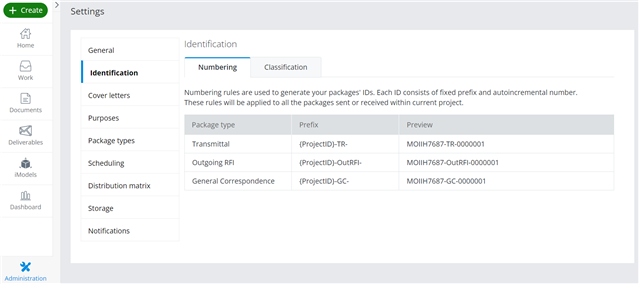

Each package in the project is automatically assigned an ID number when it is created, based on the default numbering rules of your project. The ID number consists of a prefix and an auto-incremented number. You can use the default prefixes as is or modify them as needed.
To modify the default package ID numbering rules:
  1. Click on the Administration button to open Deliverables settings page.
  2. Go to the Identification tab and click the Numbering tab.
  3. Click in the Prefix field of the Package type whose numbering rules you want to change.
    Default package type prefixes in new projects:
    Package typePrefixPreview
    Transmittal{ProjectID}-TR-Daph123-TR-0000001
    Outgoing RFI{ProjectID}-OutRFI-Daph123-OutRFI-0000001
    General Correspondence{ProjectID}-GC-Daph123-GC-0000001
    Note: The {ProjectID} variable in each default prefix resolves to the ID of the ProjectWise project.
  4. When finished editing a prefix, click the check mark icon inside the Prefix field to apply the changes
