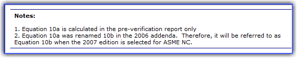

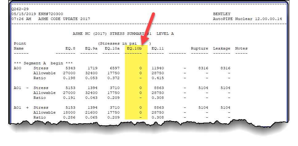

Why are the results for Eq.10b (known as 10a prior to 2007)  in AutoPIPE's Stress Summary Output always zero?

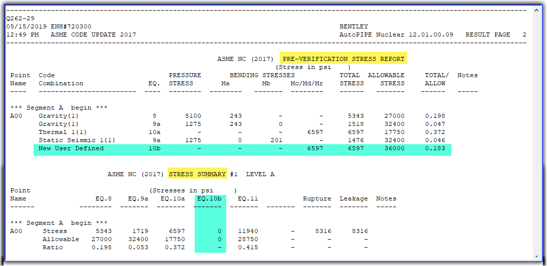

 AutoPIPE is printing Equation 10b ( (known as 10a prior to 2006 addenda) in the report for pre-verification only. See AutoPIPE help section below:
Equation 10b is only analyzed when a Single Non-Repeated Support Movement load case has been defined (see AutoPIPE help for information on "Stress Due To A Single Non-Repeated Support Movement")
"Stress Summary" sub-report using Results> Output Report
