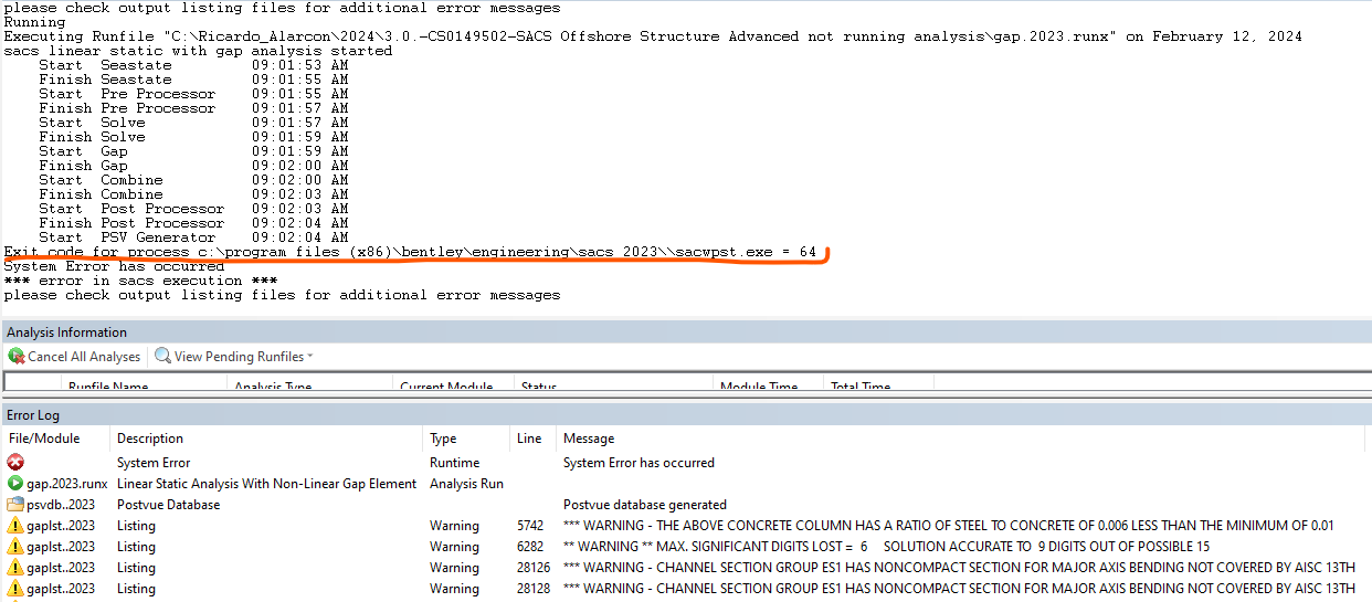

Community Question:
Hello Bentley I'm trying to run some analysis in version 2023 and I was facing this kind of error, someone could explain the reason for this?
Answer:
This error in version 2023 could be due to several bad configurations in the model and someones could be due to some little bug in the system that we are working to solve; next, we try to list the principal reason that so far we have found
Working with Concrete sections
If you are working with sections of concrete and get this issue, the root of this problem is that postprocessing is not able to recognize concrete sections, this bug already has been reported and our developers are working to fix it
Working with Spans
if this error is presented while you try to run a static analysis and if the model includes some Span lines defined, it's probably that this will be the root of this issue, version 2023 presents a light error at the moment to read the information of spans during the postprocessing this give as a result the error system error
