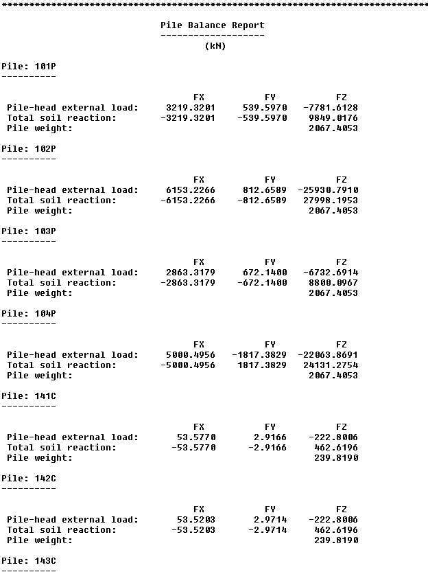

Hello Bentley, during a Collapse analysis where can I find the reactions in pileheads?
Answer:
You can know the reactions for all pile heads depending on your load sequence, for this you need to go to the next report in the output file, this will show you the maximum load reported in the last load step in your load sequence

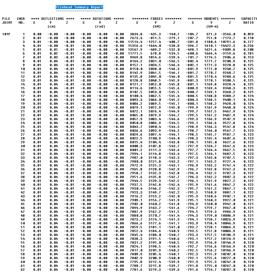

You also can search inĀ  the Pilehead Summary Report
