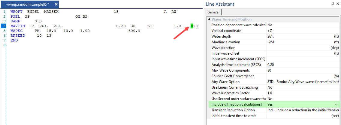

For Dynamic Analysis:
Use 'D' option in WAVTIM line column 76 to include diffraction calculations.
