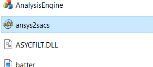

How to convert an ANSYS file into a SACS file?
SACS installation directory contains a tool called ansys2sacs.
Use this tool to import the Ansys model and proceed for the conversion.
However, please be alert that it is not possible to convert all the features from one program to another.
