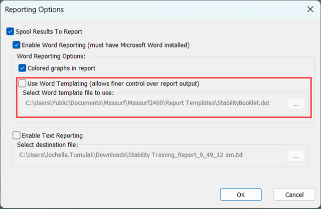

You may use the Stability Template provided by Maxsurf found on this path for the Maxsurf 24.00.00.722:
C:\Program Files\Bentley\Offshore\Maxsurf 2024\bin\win64\Report Templates
Go to Results | Reporting Options
Tick Spool Results to Report and choose your preference.
