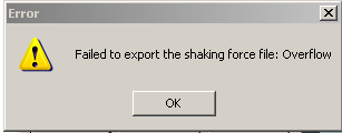

The following is displayed when exporting shaking forces:
Error
Failed to export the shaking force file: Overflow
OK
Answer:
During the creation of the HMF file using File> Export> Shaking Forces, for some models the program may crash if the Analyze> Force direction command shows the AutoPIPE axes to be zero vectors.
A new enhancement (CAE-CR-7856) has been added to a check for zero cosines when using File> Export forces.
It is unknown what causes 0 direction cosines in some models.
Workaround,  if direction cosines are zeroes, set them to unit vectors by using "Edit> Shaking Forces".

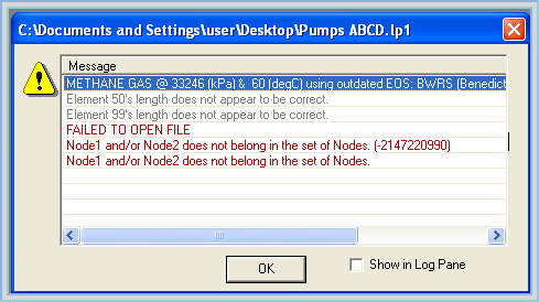

The following is displayed when importing a model from AutoPIPE:
length does not appear to be correct
Failed to open file
does not belong in the set of nodes
What is the problem and how to avoid / fit?
Answer:

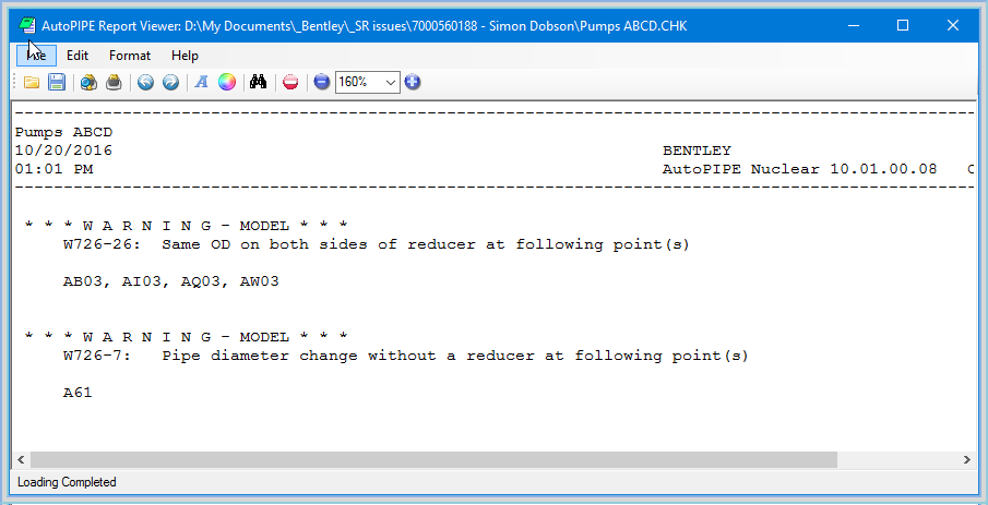

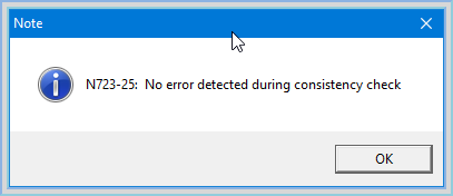

Open AutoPIPE model, select Tools> Model Consistency check.
A report will be generated and displayed on screen. Any and all warnings related to piping geometry must be fixed before exporting to PULS.
Example:
Therefore, all reducer issues in this example model must be fixed before exporting the file to PULS.
The goal is to fixed / reduce the number of warnings in AutoPIPE until the following is displayed when running this command:
