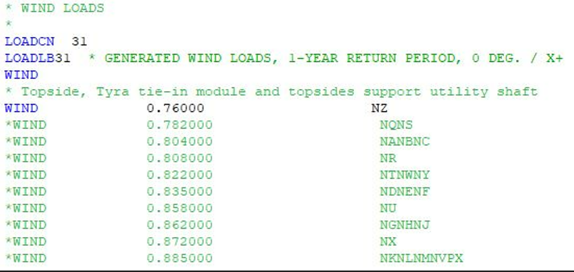

Hello Bentley, In one load condition, the wind loads are acting on various (vertical) areas of an offshore platform. Those areas can be found at various heights, which means that various wind pressures are to be used in the load condition, However, SACS only seems to accept ONE wind pressure per load condition. Is there an option to use VARIOUS wind pressures in one load condition? I need to include something like this

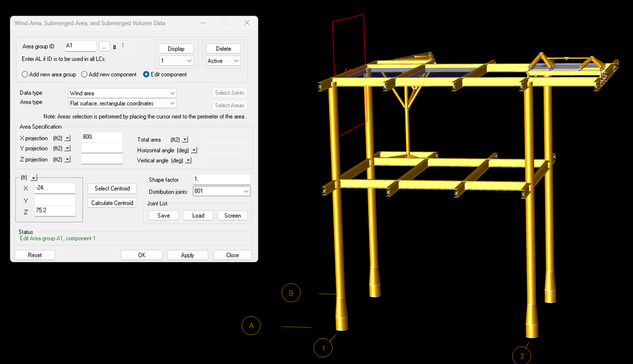

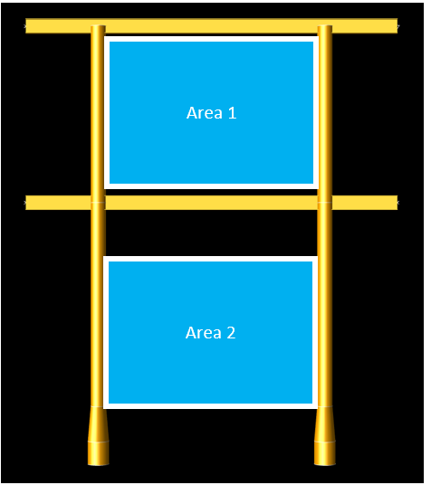

For this little example, we have added two projection areas in X direction with the same area but with different height
Area 1 A = 800ft^2    center of application  x=-24ft y= 0ft and z=75.2ft
Area 2A= 800ft^2    center of application  x=-24ft y= 0ft and z=31.5ft

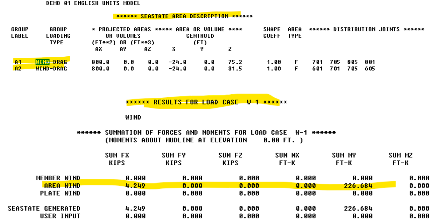

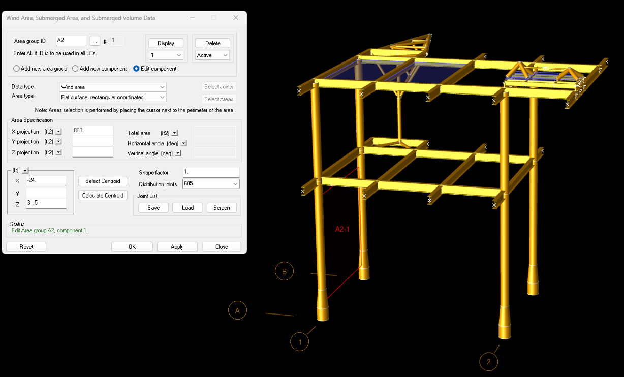

SACS Results
Below is shown the result in SACS

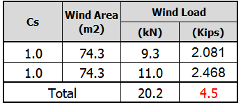

As can you see, SACS has calculated a force of 4.25 Kips, now, below will be shown the hand calculation to corroborate this force

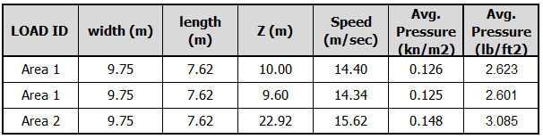

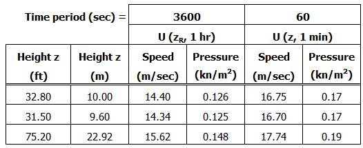

Following the previous calculations for each height, we can get the result of pressure and force on each elevation required
As can you see comparing the results, SACS gives us a force of 4.25 kips, and in our hand calculation we get 4.5 kips, with this we can corroborate that the generation of force using the Seastate module is correct.
In summary, you don't need to include different velocities or pressures, SACS only uses one velocity or pressure for reference for calculating the pressure and forces for the different positions of elements or areas

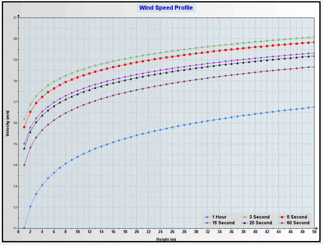

Below is presented the wind velocity and pressure profile considering a reference velocity of 14.4 and a height reference of 10 meters for each time gust recommended by API
