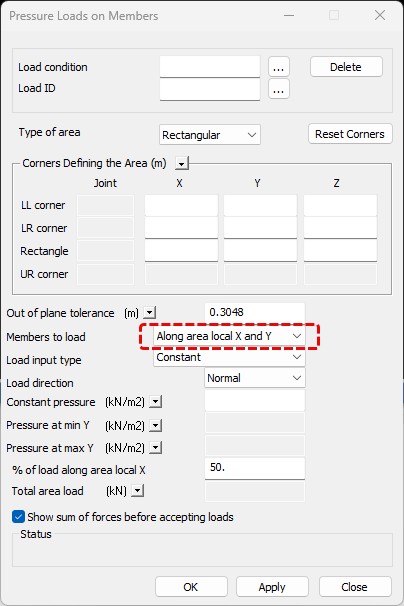

Plate area Load in SACS
How can I apply the plate load in a SACS model and then transfer it to member load, in a similar analogy with StaadPro Floor Load?

The first two options will produce the same results. 1/4 of the total load (for quads) is distributed to each node as a joint load. With the third option, the internal loads are calculated for the plate due to the pressure, and those end forces are distributed to the corner nodes. So, with the third option you will get moments at the nodes due to the internal loads in the plate. None of these options will result in loads being distributed to members. The plates are always connected to joints.
The only way to distribute loads to a beam framing a plate would be to model the load as a member area load.
There is an option to distribute the loads in both the local x and y directions of the plate, which should produce a similar result to the FLOOR LOAD command from Staad.Pro.
