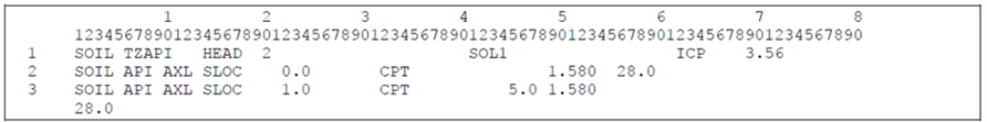

I have a set of offshore cone penetration test (CPT) data. How to import them into my psi input file?
PSI provides 4 methods to generate T-Z curves using CPT-based methods which are recommended by API:
The CPT method is specified on the TZAPI HEAD line. In the example below, the T-Z curve is being generated based upon the ICP method:
Please see section 2.4.3.5 of the SACS PSI manual for further explanation on the above example.
