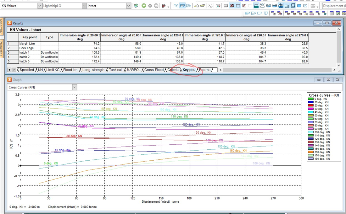

How do i plot on the same graph both downflooding and deck edge immersion angles
Depending on your requirement, you can try doing KN Analysis.
The analysis settings required for KN Values analysis are:
• Heel from the Analysis menu, select range for analysis
• Trim (fixed or free) from the Analysis menu
• Displacement from the Analysis menu, select range for analysis and specify estimate of VCG if known

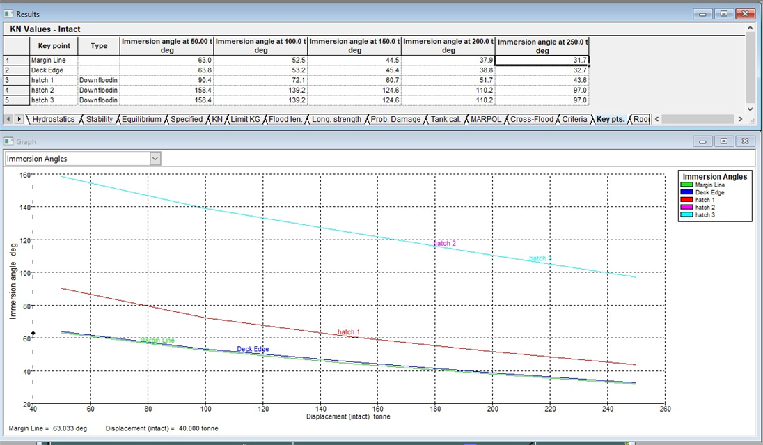

You can indicate your key points found on the Input Window and set it to "downflooding point" under type.
The output is in the form of a table of KN values and a graph of Cross Curves of Stability. Furthermore the immersion angles of the keypoints and margin line and deck edge are computed for each displacement, and the graph of the immersion angles can be found in one graph.
