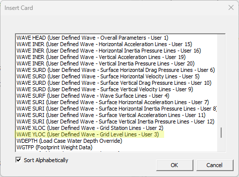

I'm using WAVE YLOC card to obtain information specifically on given elevations from the seabed to a certain point above the sea surface, but SACS produces "FORMAT ERROR". How can I resolved it?
You cannot simply type in datagen WAVE YLOC as this will output a "Format Error". The correct input as below:
OR you can select to input the card so that the line can be correctly defined:
