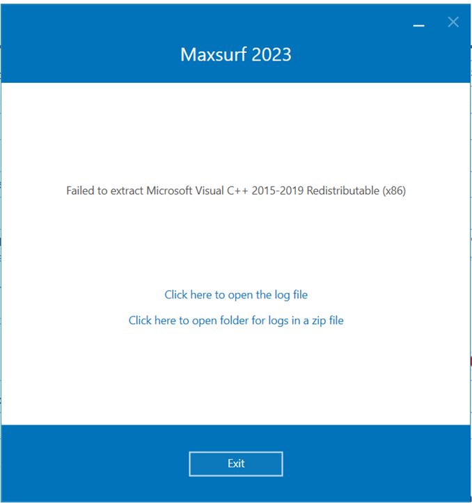

"Failed to extract ...." message appears when trying to install MAXSURF
Product(s):MAXSURF
Version(s):23.07.00.268
Area:Installation
The error "Failed to extract..." occurs during installation.
There could be any number of reasons why the installer could not run as intended:
Solution #1:
1. Reboot the computer.
2. Next, download the application from Bentley's Software Download.
3. Move the downloaded software to the computer where the application is to be installed.
Note: Do not install the application from a remote location.
4. Contact Company IT Department asking them to suspend Virus protection and provide Admin rights for installing the application.
5. Install the software.
Solution #2:
1. Install CONNECTION Client
2. Install the latest Microsoft Visual C++
3. Reboot the computer.
4. Install MAXSURF software.
