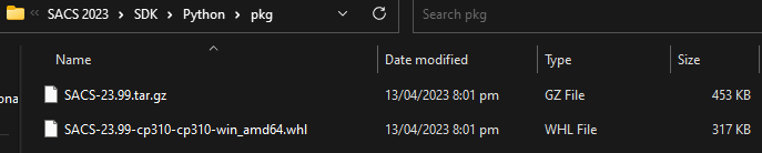

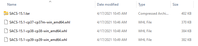

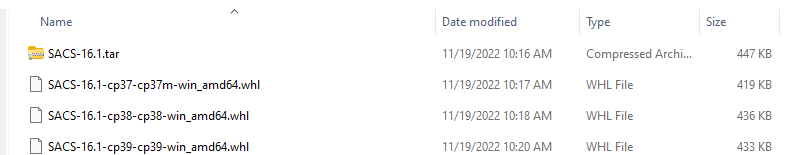

SACS Python installation is only supported for the next versions 15.1, 16.1, and 2023, to perform this installation you need to go to the pathway a look for the folder SDK\Python\pkg, depending on the version you will show the next files
there are two ways to go about it.
  1. PIP installation using the *.whl file provided.
  2. Compiling your own python installation using the *.tar.gz file provided.
Version 15.1
Version 16.1
Version 2023

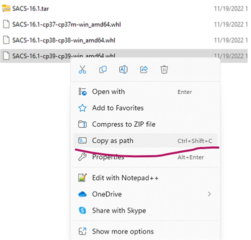

Method 1. You need to do the following.
SACS-16.1-cp37-cp37m-win_amd64.whl This version is compatible with Python 3.7
SACS-16.1-cp38-cp38-win_amd64.whl This other one is compatible with Python 3.8
      SACS-16.1-cp39-cp39-win_amd64.whl and finally this one is compatible with Python 3.9
Only one of these files is necessary to install, I recommended you install in version 3.9

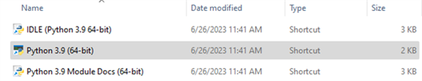

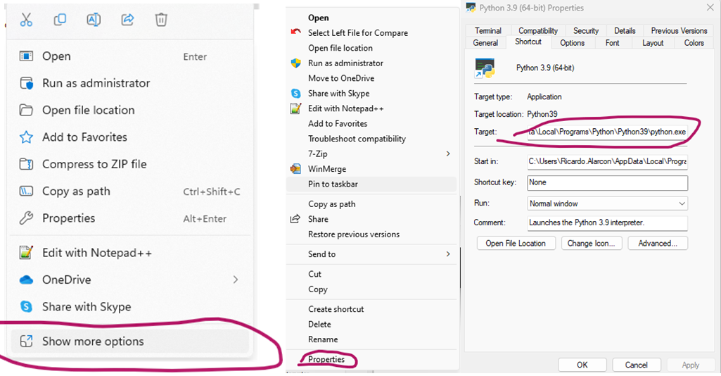

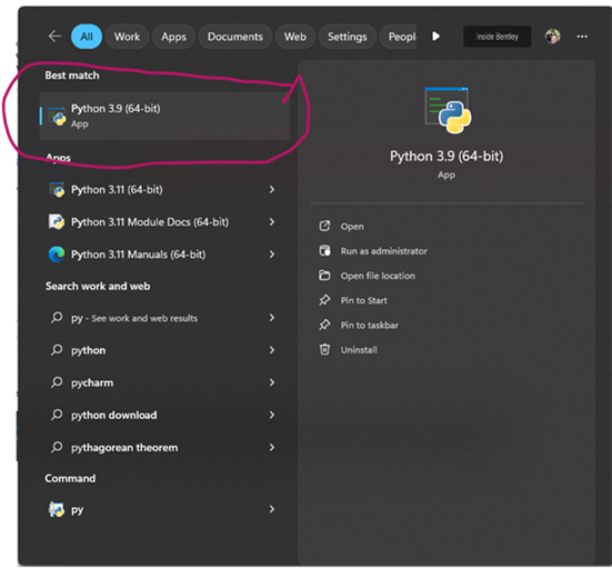

So, now how can I perform the installation of SACS API? Please follow the next process
"Python" and then, make a right click and, "Open File Location", then make right click on the "Executable" file and select "Show More Options" go to the "Properties" and finally copy the "Target"
