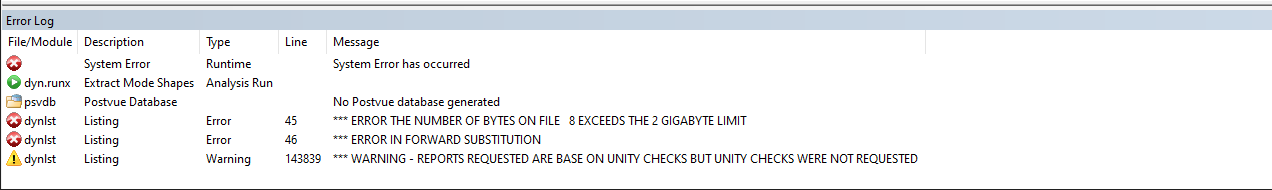

"ERROR THE NUMBER OF BYTES ON FILE X EXCEEDS THE @ GB LIMIT"
Product(s):SACS
Version(s):All
Area:Executive
Hello Bentley, I have this Error, "ERROR THE NUMBER OF BYTES ON FILE X EXCEEDS THE @ GB LIMIT" Could you please advise me or explain the root of this??
One of the disadvantages of having a high detailing level modeling is sometimes counterproductive, we have come across several cases when the model is too large and exceeded the limits of nodes making the solution will be too large that the internal scratch file size exceeded the limitation of the software. This will result in an issue to create the solutions files. The scratch file size cannot be larger than 2 GB. You will get this error when this happens.
