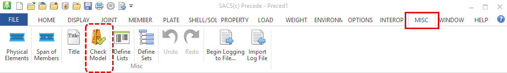

The Precede command Misc > Check Model will validate the model for some common errors. Note that some reported errors are not necessarily an indication that there will be issues with the analysis. Check Model can give some clues as to why a model may be experiencing errors.

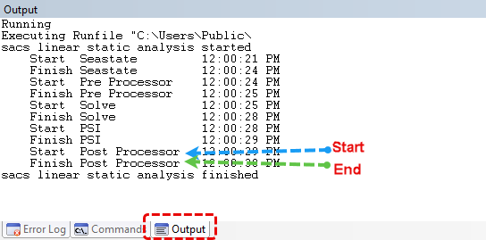

    If an analysis exits with an error, we can identify where the analysis stopped by referring to the Start and Finish messages. The program that exited with an error will just have a Start message. For instance, if there was an error in the Post Processor, we would just see the Start Post Processor message. This error may be related to input errors related to previous programs, but this will give us our first place to start digging into the error.

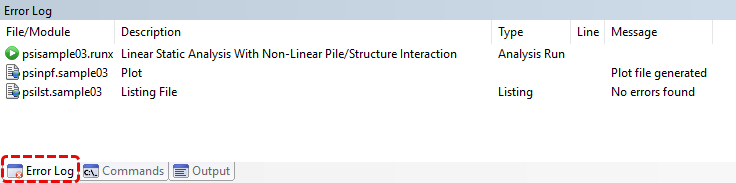

    You will often be able to identify the source of the problem by reviewing the listing file. Error and Warning messages will be printed to the Error Log pane in SACS Executive. Double-clicking the error message will open the relevant listing file. SACS will sometimes print additional relevant output before or after the Error message that can provide additional context. The location of the Error can also provide some clues as to what happened in the analysis. For instance, if the analysis stopped after the member properties report, but before or during the plate properties report, that is a good indication that something went wrong with reading the plate properties, so more scrutiny should be applied to the plate definition input.
