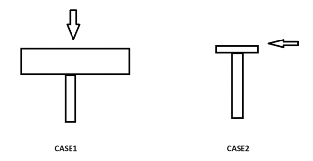

Now, let me try to explain the same with a figure. I tried to develop 2 cross sections of Tee, one with strong flange and the other one with strong web and applied load such that minor axis bending will be generated within the entire section.
Now, in Case1, if you consider the web of the section itself, then you will see the stem will be experiencing “Major” axis bending due to the applied load. Similarly, in Case2, the flange will be experiencing a load which will cause “Major” axis bending to the flange itself. Thus, the global minor axis bending load is simulating local major axis bending to the individual components of the Tee section.
SACS is using LTB for F11.2 (a to c) section, which is mentioned for “Major” axis bending for the individual parts (flange and web) as rectangular bars.
This approach is considered as a conservative design since AISC does not provide any specific guidance for Tee sections minor axis bending.
