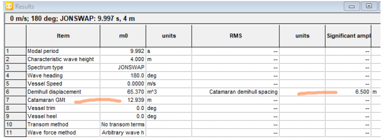

Issues with motions calculations.
1. GMt and displacement values for catamarans.
Summary table gives the displacement of the single demihull and the GMt for the catamaran
