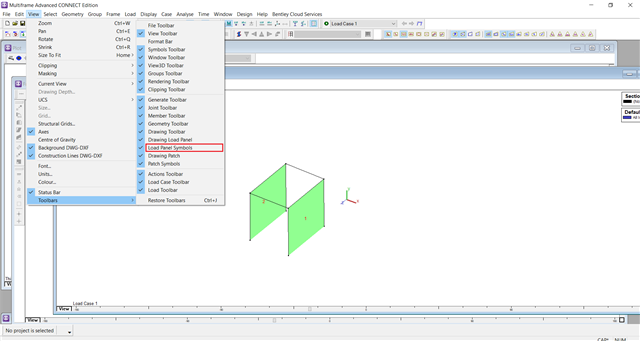

Switch to load Window, then go to View -- Toolbars -- Load Panel Symbols to locate the toolbar.
load panel symbols

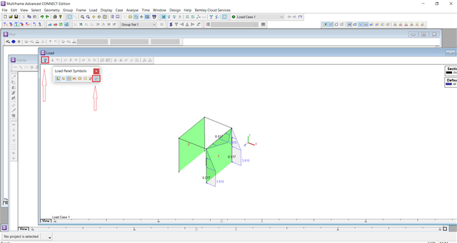

Turn on both Load Label Display and Load Panel Side Loads icons shown in the attached file.  Loading values will be displayed in diagram.
load panel side load
