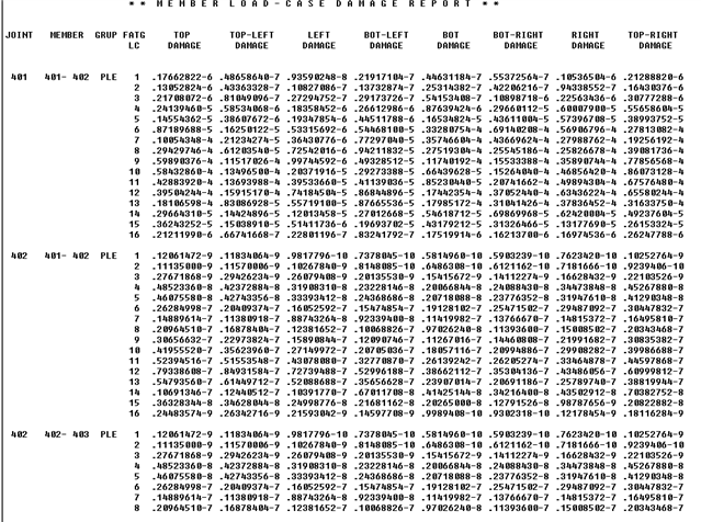

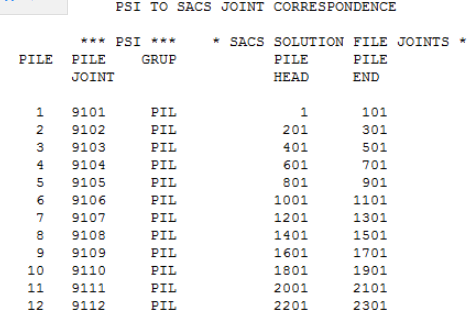

automatically SACS will create 100 segments in each pile, this means that each pile will create 101 joints for 100 segments, if the pile length is 100m, each segment will be 1m long
If you have 12 piles and, if you use the default segmentation of SACS (100 segments per pile), the joint results will be similar to the next picture.

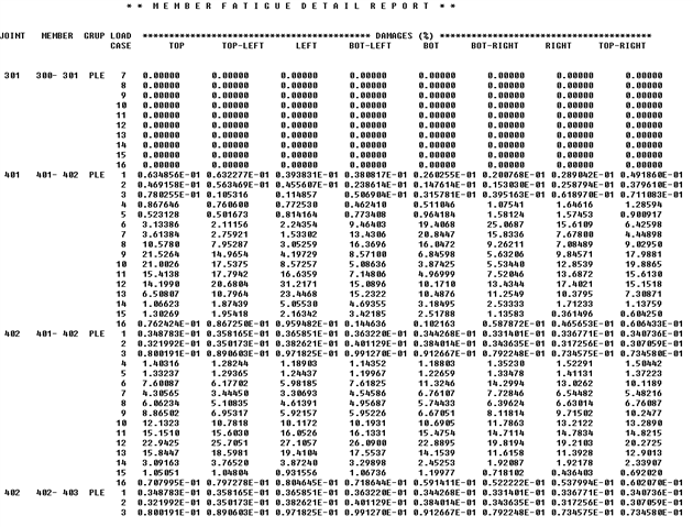

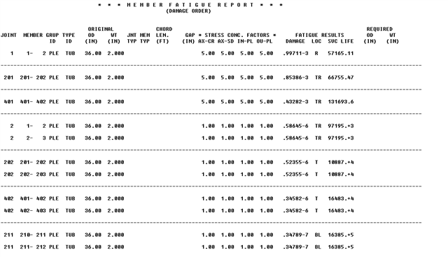

if there is a  location in which you would like to override SCF, you can define it in your ftg.inp using the card JNTSEL and JNTSCF
