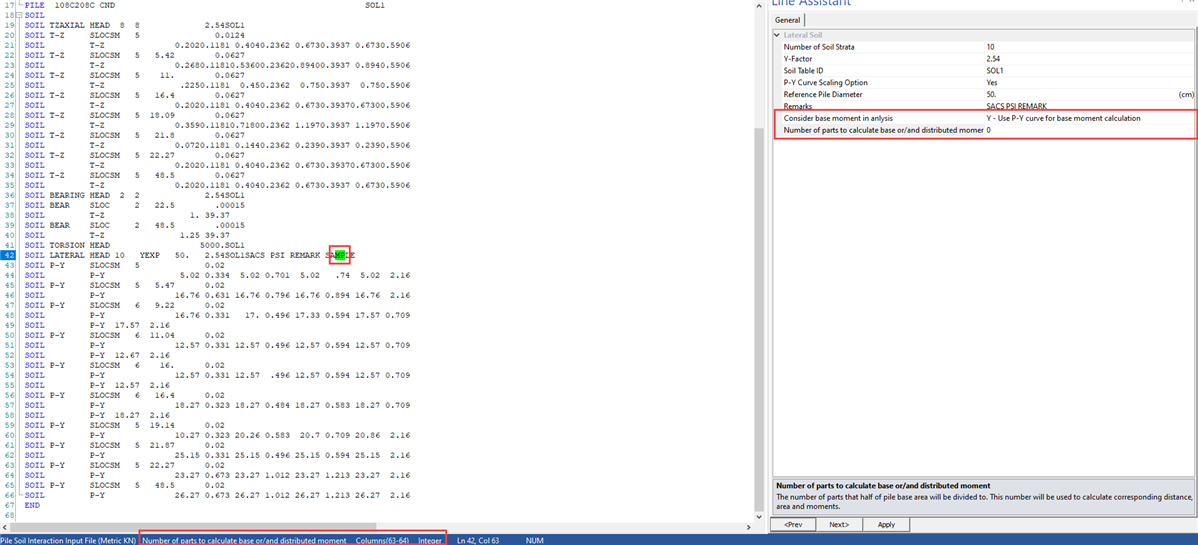

Why is my PSI analysis getting a System Error after I updated my version?
Users report input which worked fine in previous releases and now it returns the following System Error:
Exit code for process c:\program files (x86)\bentley\engineering\sacs connect edition v16\\\x64\sacwpsi.exe psiinp.dat = 64
New options or base shear and base moment were added to PSI input file in release 15 using columns that were not used before. Some users used these columns to add more text to the Remark. In this case, user should review the input file and rewrite the Remark considering the new input format.
Please see the Remark columns in the next samples for clarification.
