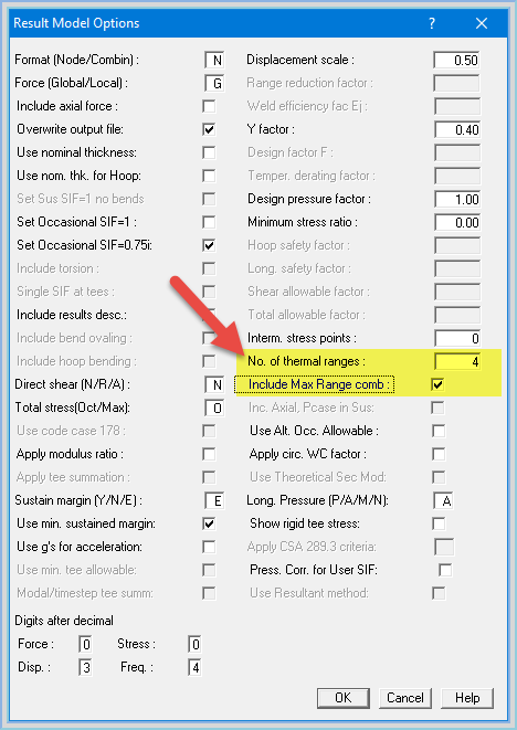

There are a number of settings that control combinations. Confirm all these settings to be as desired:
These settings will only affect Code Stress Combinations. See AutoPIPE help to understand these settings in detail.

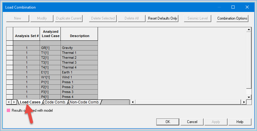

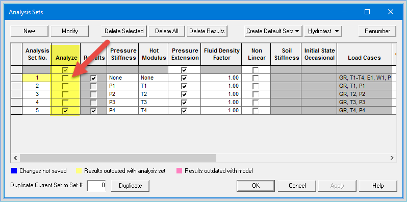

Confirm Analysis Set to be analyzed was set to do so:
a. Load Case tab, confirm all the load cases are listed

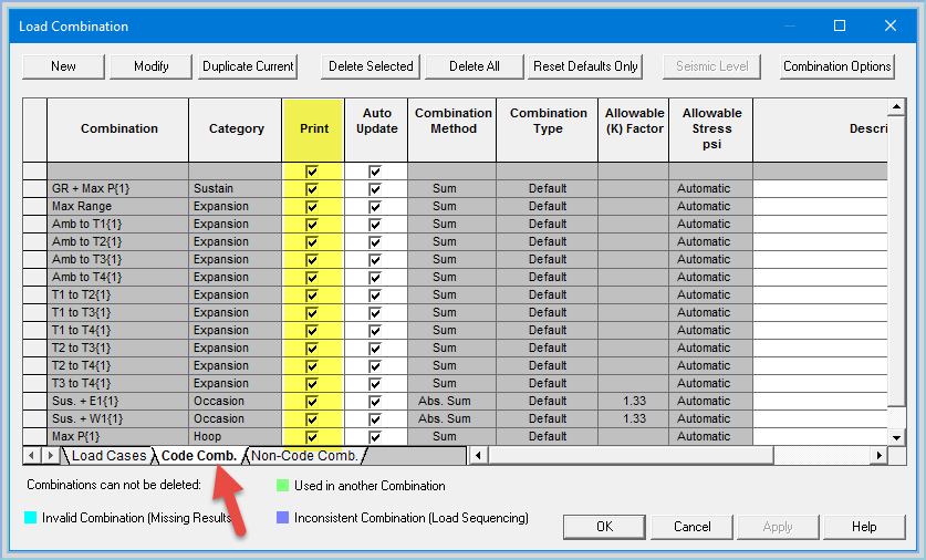

b. Code Comb. tab, confirm all Code Combinations are correctly listed. While on this tab, suggest to press Delete All button, and then Reset Defaults Only button. Also verify that print is enabled for all combinations

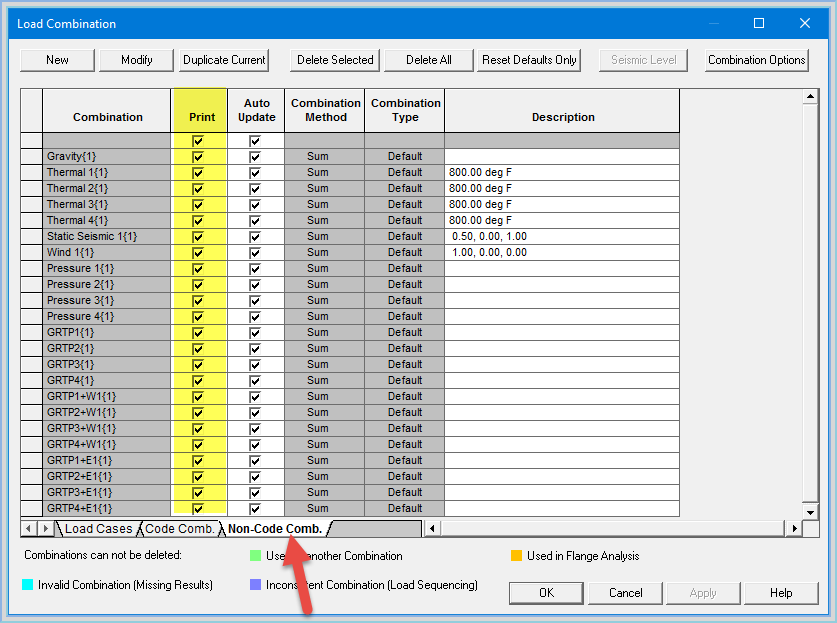

c. Non-code Comb tab, confirm all non-code combinations are correctly listed. While on this tab, suggest to press Delete All button, and then Reset Defaults Only button. Also verify that print is enabled for all combinations
Only combinations on the Code Comb. tab with print enabled will show up on the interactive floating dialog for Results> Code Stresses
Only combinations on the Non-Code Comb tab with print enabled will show up on the interactive floating dialog for the other categories (Displacements, Restraint, Support, Forces and Moments, Soil, Mode Shape) results.
