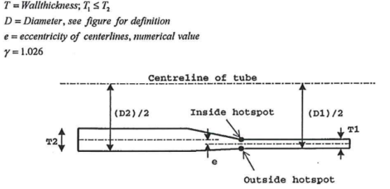

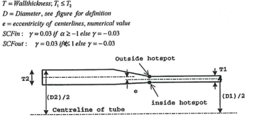

Design Equation SCF for tubular to tubular Girth Weld
This formula is used when the thickness of the connection is alined inside
This formula is used when the thickness of the connection is alined outside

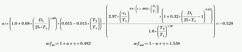

Example
Data:
D1 = 184 cm
T1= 4 cm
D2= 192 cm
T2 = 8 cm
Considering the connection is alined inside

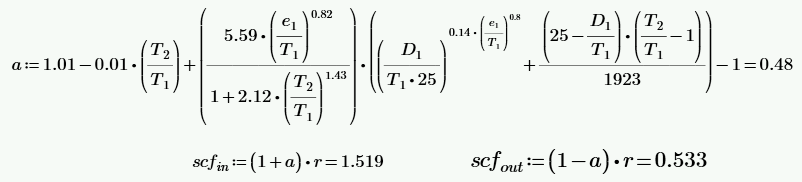

Considering the connection is aligned outside

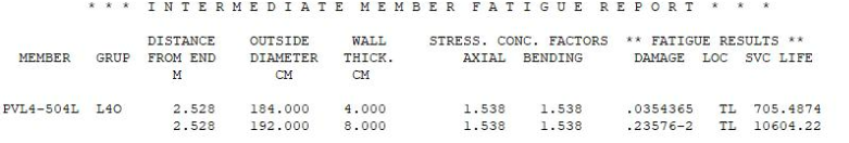

Comparing the results with the output file
