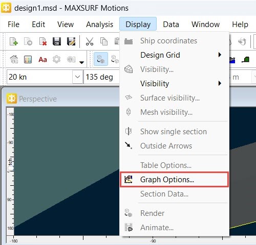

Why is it that I can only see the Roll RAO Values on the results graph?
- Go to the Graph Window and select the desired graph on the dropdown button located on the upper left corner of the Graph Window.
- Once the Graph Window is active, go to Display | Graph Options

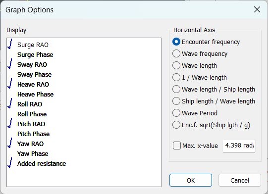

- Once a graph has been chosen, the various data sets in the graph may be turned on or off. Turn on the desired data sets and select the desired horizontal axis format.
From there you can now the other results on the graph.
