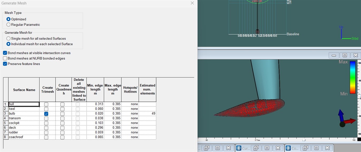

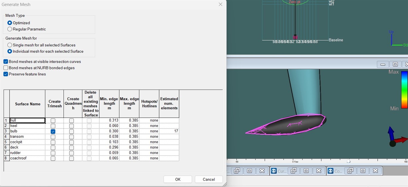

Trimesh is not properly built when created from surfaces.
There need to be enough elements to create a properly build trimesh. See the comparison below of 17 elements and 49 elements trimesh.
