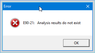

After conducting analysis I got error:
Error
E90-21:   Analysis results do not exist
OK
What can be the reason?

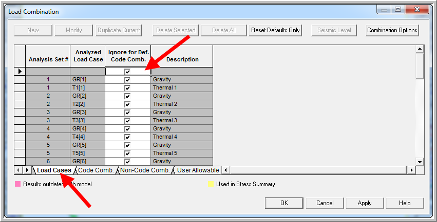

Avoidance #1:
1. With your model opened in AutoPIPE, select Analyze> All, the program runs the analysis in the background.
2. Open the Combinations dialog screen and select the Load Cases tab:
3. Confirm that "Ignore for Def. Code comb" check-boxes are all checked for all load-cases.

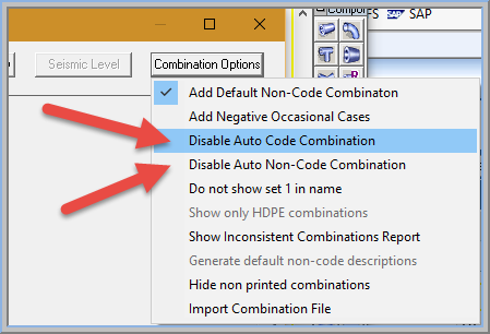

Avoidance #5:
Open the Tools> Combinations dialog, check to be sure that the following combination options are disabled,
"Disable auto Code comb"
"Disable auto NonCode comb"
Also be sure that "Add default Non-Code combination" is checked ON.
After confirming these settings, try to reanalyze the model and review the code combinations / results.

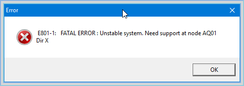

Known issue #2:
The model was analyzed but all analysis sets had errors.
Example: When running an analysis the following appears for all analysis sets...
Error
E801-1: FATAL ERROR : Unstable system. Need support at node AQ01 Dir X
OK
In this case the analysis was not completed and when trying to review combination the E90-21 error message will be displayed.
Avoidance
Make modifications to model to prevent E801-1 fatal error message from being displayed during analysis. See WIKI here for detailed suggestions

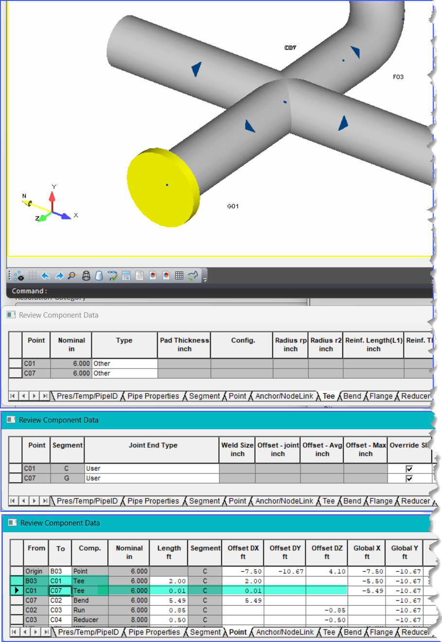

Known issue #3:
The model contains a component that is not supported by the current piping code (ex, ASME B31J Cross Piping component).
The only avoidance:
      1. Select a different piping code / code year that supports a cross component.
      2. Model back-to-back tees defined as Type = Other, separate tees by a very small distance between them, hand calculate a user SIF, and insert user SIF value into respective tee node points.
