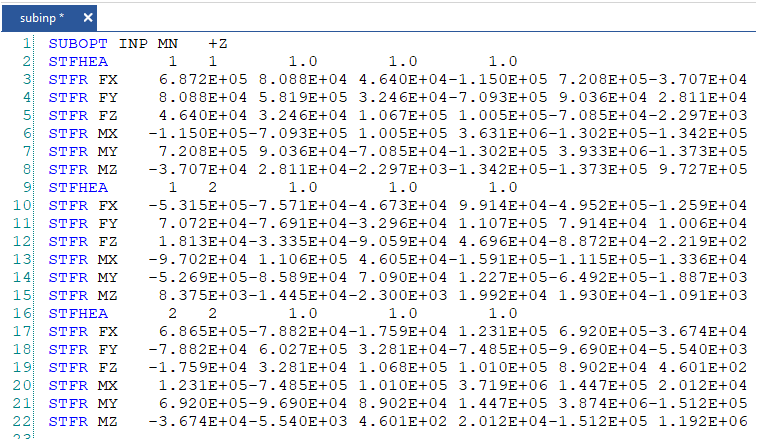

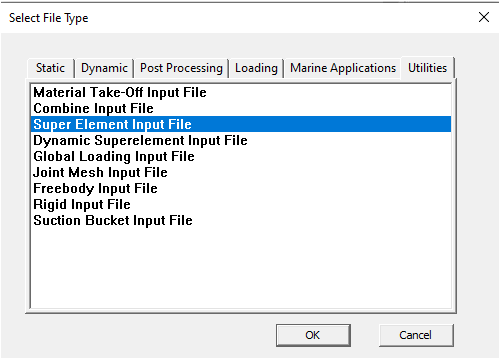

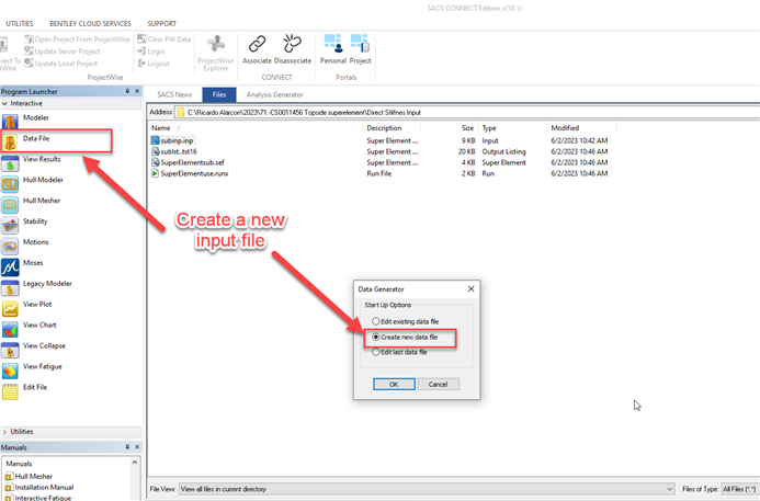

To create the Deck super element you have to create a new Super Element input file and once the file was created we work only with the "SUBOPT", "STFHEA", and "STFR" cards.
In the card SUBOPT you can set the primary function to be executed RET, XPN, MER, MOD, and INP. Also in this card, you can set the units and the direction for the vertical coordinates
In the card STFHEA, you should set the 1st and 2nd joints for the stiffness partition.
you can input the Stiffness Matrix Row with the card STFR

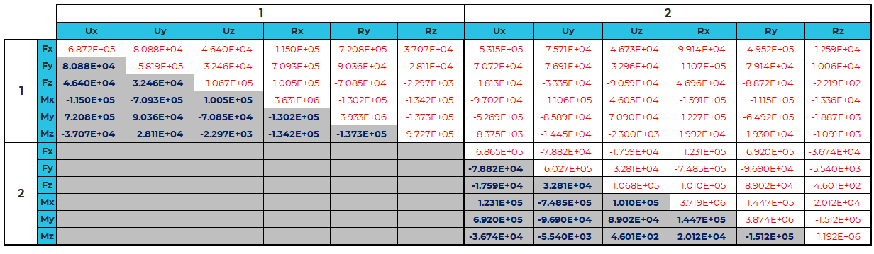

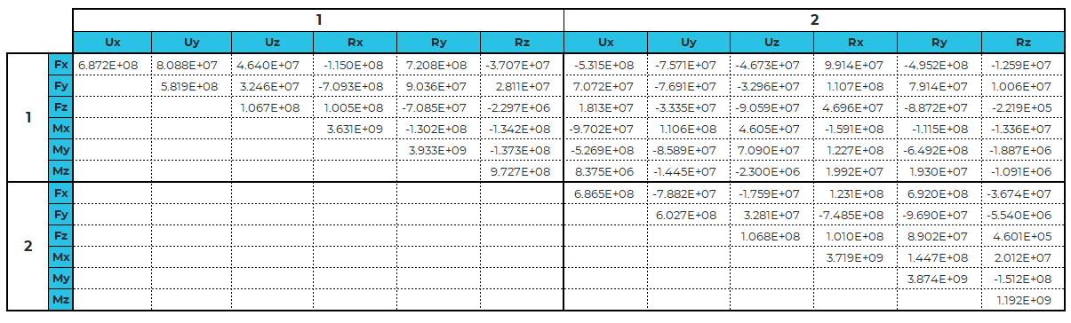

Below is presented the normal Stiffness Matrix for a structure with 2 points that we have to input to create the super element for the Deck
As you can see the stiffness matrix in the image is shown as a triangular matrice so we have to input this as a symmetrical. It means that K(row#, column#) = K(column#, row#) -That's why you have only the upper part of the stiffness matrix in the Picture. we can't leave the lower part of the matrix blocks blank in the input file. so we need to enter the stiffness matrix components based on the symmetry of the stiffness matrix. For example, in the first block (joint 1 to joint 1), K(1,3) = K(3,1).
Below is shown the correct way to input the stiffness matrix
finally, the value shown in the screenshot above could be input at our input file.
