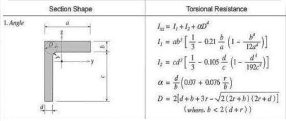

How does SACS calculate the shear stress due to torsion for a C-channel?
Answer
b = d = 8 mm, a = 100 mm, c = 92 mm, D = 12.11 mm, α = 0.146, I1 = 16,203.89 mm4, I2 = 15,271.15 mm4
Ixx Angle = 34,609.64 mm4 → Ixx Channel = 69,219.28 mm4

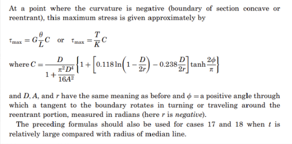

D/2r = 0.757, A = 3,071.6 mm2, tanh(2Փ/π) = 1, C = 0.0222 1/mm
Гmax = 207.576 MPa
For more information, please refer to Roark's formulas for stress and strain - page 407.
