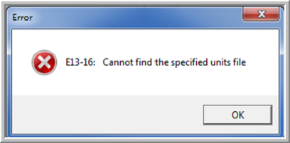

The following is displayed when opening a model in AutoPIPE:
Error:
E13-16: Cannot Find the specified units file
OK
How to fix this issue?

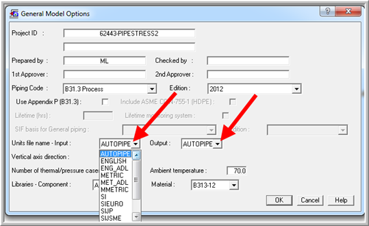

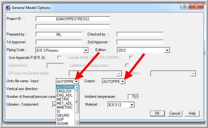

The problem is that your version of AutoPIPE does not have the same Units file as was last used when the file was last saved.
Avoidance:
Select the Tools> Model options> General command to open the General Model Options dialog screen. Select the drop-down arrow and select a unit file that is available in your version of the program. Shown below:
Typically the Input and Output unit files match.
