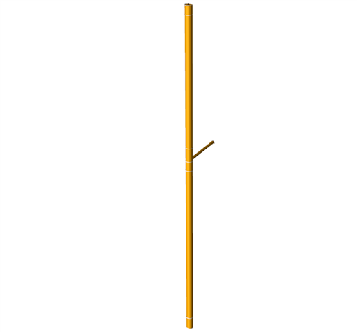

Let’s take a look at an example for a simple connection to see the how this difference occurs in practice.
For this example we will focus on a simple T joint made of a 41.25x1 in tubular chord with 42x1.375 in tubular cans and a 16x0.625 in brace.
The transfer function will be limited to two waves at 6.0 s and 5.0 s to reduce the amount of data that we need to work with for this example. Realistically many more waves would be required to accurately define the transfer function.
First, we will perform a modal analysis to determine the natural period and mode shapes of the structure. We can also determine the modal internal forces in the members by solving the linear static analysis of the displaced shape.
