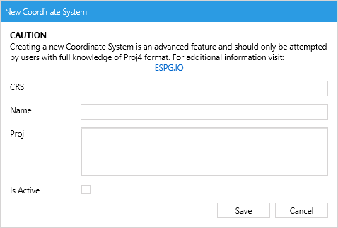

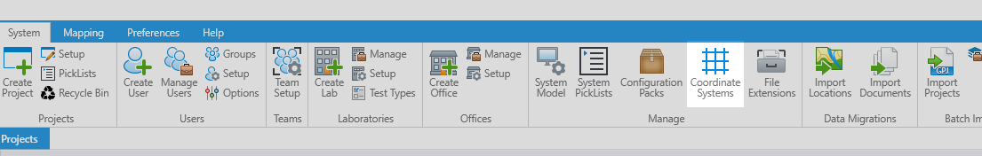

Step 2: Add the Coordinate System in OpenGround Professional
- Navigate to: System > Coordinate Systems > Add
- In the dialog window, enter the following:
- CRS Value: The EPSG code (e.g.,
EPSG:26919
- Name: A descriptive name for the coordinate system (e.g.,
NAD83 / UTM zone 19N
- Proj.4 String: Paste the copied Proj.4 line
Example:
+proj=utm +zone=19 +ellps=GRS80 +towgs84=0,0,0,0,0,0,0 +units=m +no_defs
- Check the "Is Active" option.
- Click Save.
The coordinate system is now available for use in your OpenGround projects.
