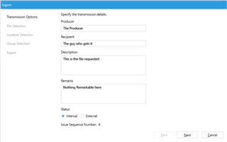

This article will explain how to export an CSV file out of a project using multiple methods.
What do I need to know to produce this?
- How to login to OpenGround Cloud
- Device Authentication (.net SDK & WebAPI)
- User Authentication (WebAPI)
- Windows Provider Authentication (.net SDK)
- Query which project I will export the data from
- Query which data tables to export data from (if not all)
- Start the Export Process
- Check the status of the export
- Download the resulting zip file of the export
