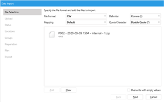

This article will explain how to import CSV Data into a project using multiple methods.
What do I need to know to produce this?
- How to login to OpenGround Cloud
- Device Authentication (.net SDK & WebAPI)
- User Authentication (WebAPI)
- Windows Provider Authentication (.net SDK)
- Query which project I will import the data into
- Create a Temporary Storage Slot for the data to be uploaded to
- Attach files to that Temporary Storage Slot for import
- Set the details of the file import and validate
- Get the status of the current file import validation
- Start the import process
- Check on the status of the current import
