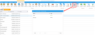

Upload your logo in OpenGround Cloud Professional by going to System>Configuration Packs>Template Images for the appropriate Configuration Pack.
Select Add and browse to the appropriate image file. Most standard image file formats are supported. The image file name will be used as the Name within OpenGround Cloud.

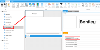

In OpenGround Cloud Template Studio, use the Static Image object to add the logo to your template. Select the ImageName for the logo you would like to use on your template.
Note that many example reports within OpenGround Cloud use the “Logo1” Template Image. Instead of Adding a new logo, you can also Edit Logo1 to replace the image with your organization’s logo.
