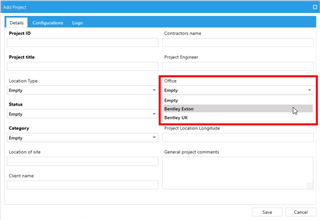

When you create a new project, you can choose the Office for that project. A different logo can be assigned to each Office, such as if your organization has different sister companies with different logos.
To add a new Office, in OpenGround Cloud Professional, go to System>Create Office.
Enter the Office details, and in the Logo tab, Add the image for that Office.
Alternatively, Logos can be added for an individual project. When creating a new Project using System>Create Project, go the Logo tab and Add the image for that Project. (The Logo can also be edited by opening the project and going to Project>Project Details).

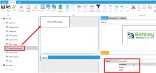

In OpenGround Cloud Template Studio, use the Project/Office Logo object to add the logo to your template.
Select the appropriate Mode. If you select Automatic, the Office logo will be used by default, unless a Project logo has been added, which will take priority and override the Office logo.
