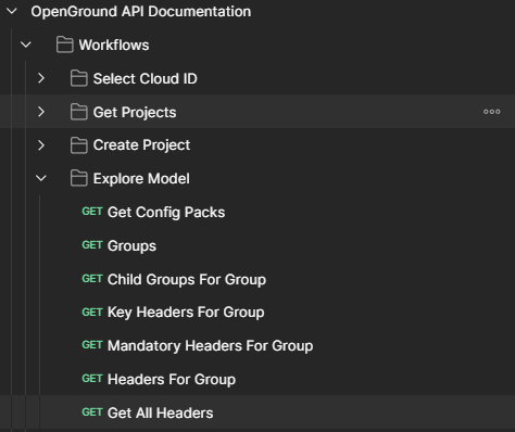

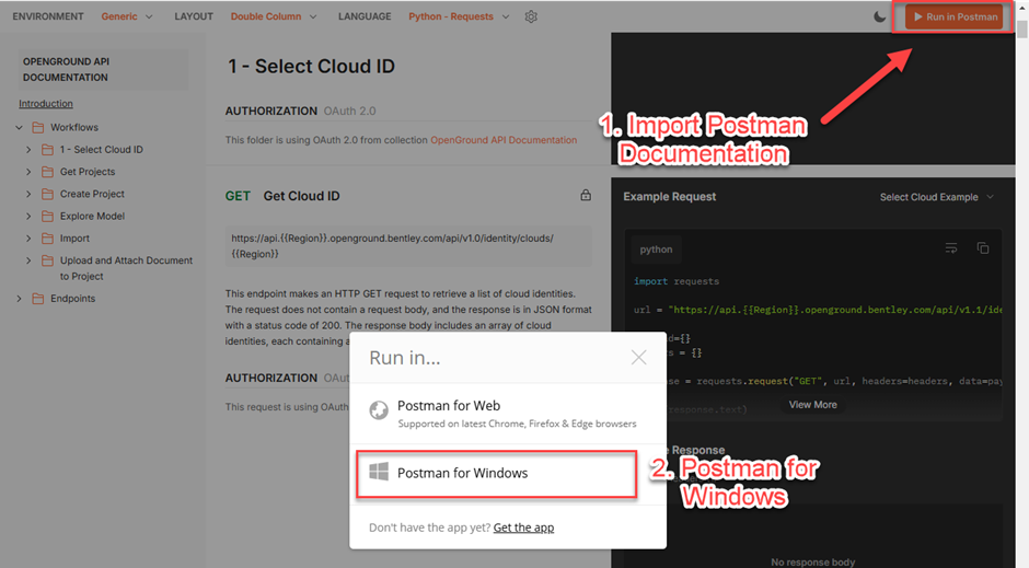

To start using OpenGround’s API with Postman, you will need to import the Postman “OpenGround API Documentation” endpoint examples and set up the Environment file to the correct region following the below images.
API documentation can be found in this Postman Collections page.

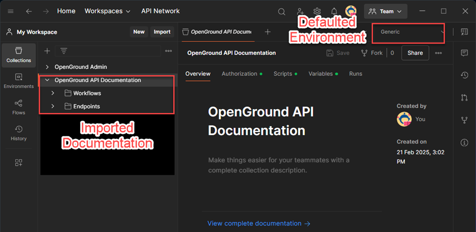

Once Imported it should look something like the below

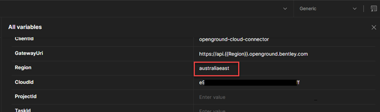

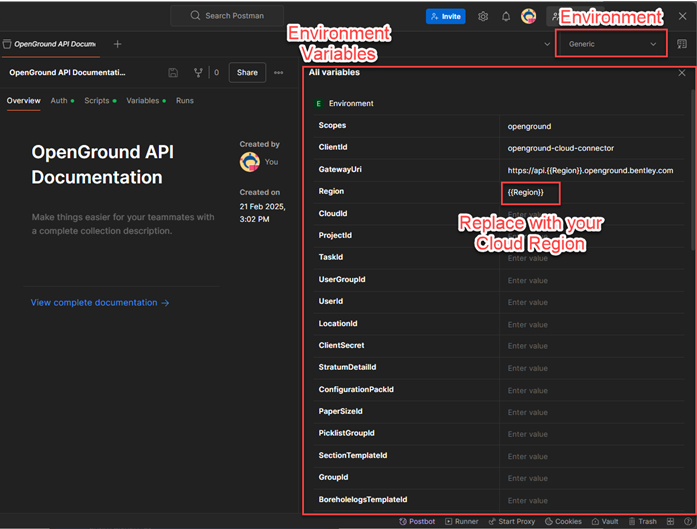

It is important to setup your Postman environment to allow for reuse of variables within your API requests.
Clicking on the “Environment” drop down will present a list of stored variables.
The “{{Region}}” variable must be replaced with the appropriate region of where your cloud instance has been setup.
Note: The region you’re operating in may not be the same region as where your cloud has been setup. If you are unsure, please contact your OpenGround Administrator within your organisation.

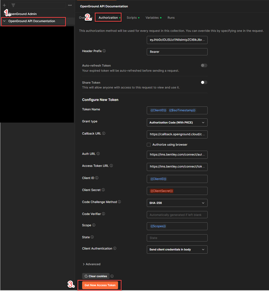

OpenGround uses an OAuth 2.0 security protocol to authenticate users accessing the API. An access token is required to Authenticate your access to the API. All the relevant Authorisation data should be prepopulated when you import the provided “OpenGround End point Documentation” and Environment file”.
Following the steps in the image below, click “Get New Access Token” and follow the login process in the browser. If successful, this means your account is now authorised to use the API.
The authorisation settings should like the below. Full Authorization parameters is summarised below.
Note: Access tokens last for 1 hour and will require you to get a new access token.

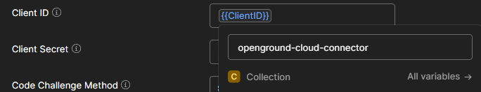

You may notice the Imported API examples use a “{{_}}” notation, e.g {{ClientID}}. This refers to “ClientID” being used as a variable within the Environment.
In this example {{ClientID}} references “openground-cloud-connector”, meaning You can view the variable value by hovering you mouse over the variable. You also can view/edit the full list of variables being used in the Environment options.

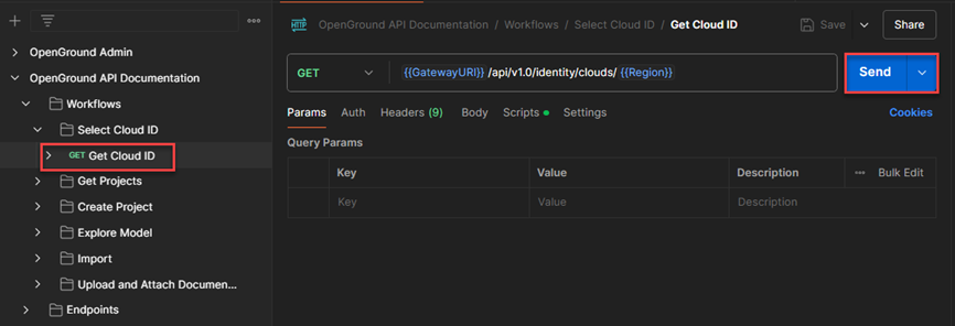

Before you can make a query to your OpenGround database, you will first need to define which cloud you want to direct you API query to by providing a Cloud Instance ID which is a unique ID defined per cloud instance. There are a few ways to obtain your Cloud Instance ID described below.

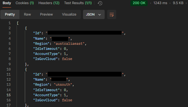

Once you have successfully imported the “API endpoints documentation”, “Postman Environment” and have gone through the Authorisation process from the previous section, you will be able to send an API request to get a response with the Cloud Parameters for the Clouds instances you have access to.
Select the query “Get Clouds” and click “Send”. No headers are required to be entered for this call
You should receive a response in JSON format, highlighting key parameters for your cloud
API EndPoint used
Method |
End Point |
GET |
https://api.australiaeast.openground.bentley.com/api/v1.0/identity/clouds/{{Region}} |

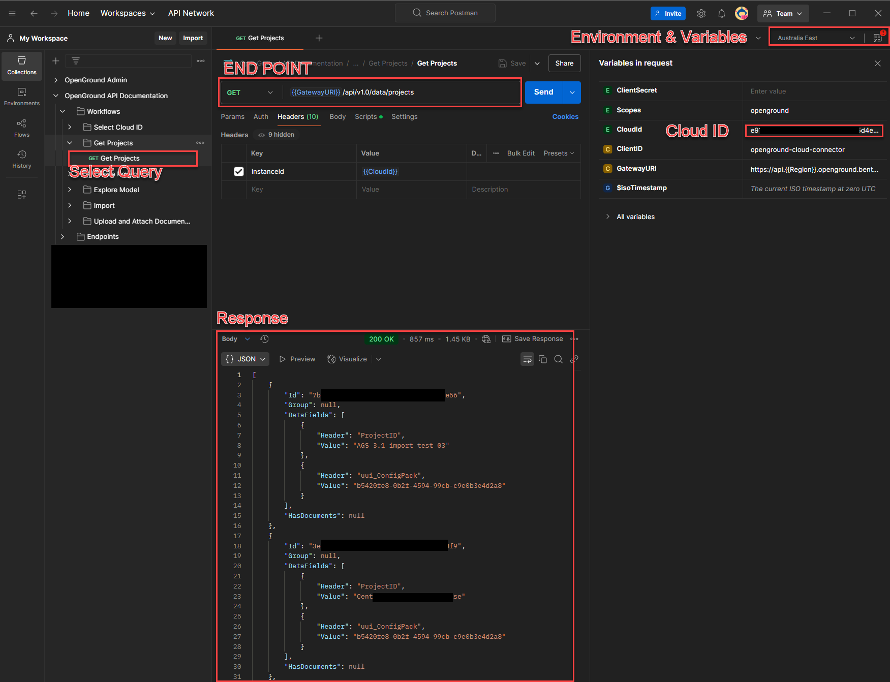

In this example you will learn how to use the API to return a list of Projects from your cloud Instance.
Prerequisites
Prerequisites can be obtained by following previous sections.
To return a list of projects on your cloud instance using the API

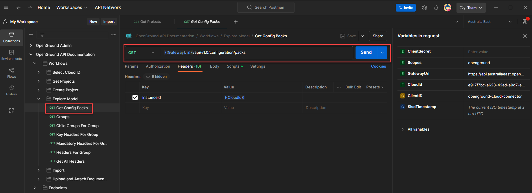

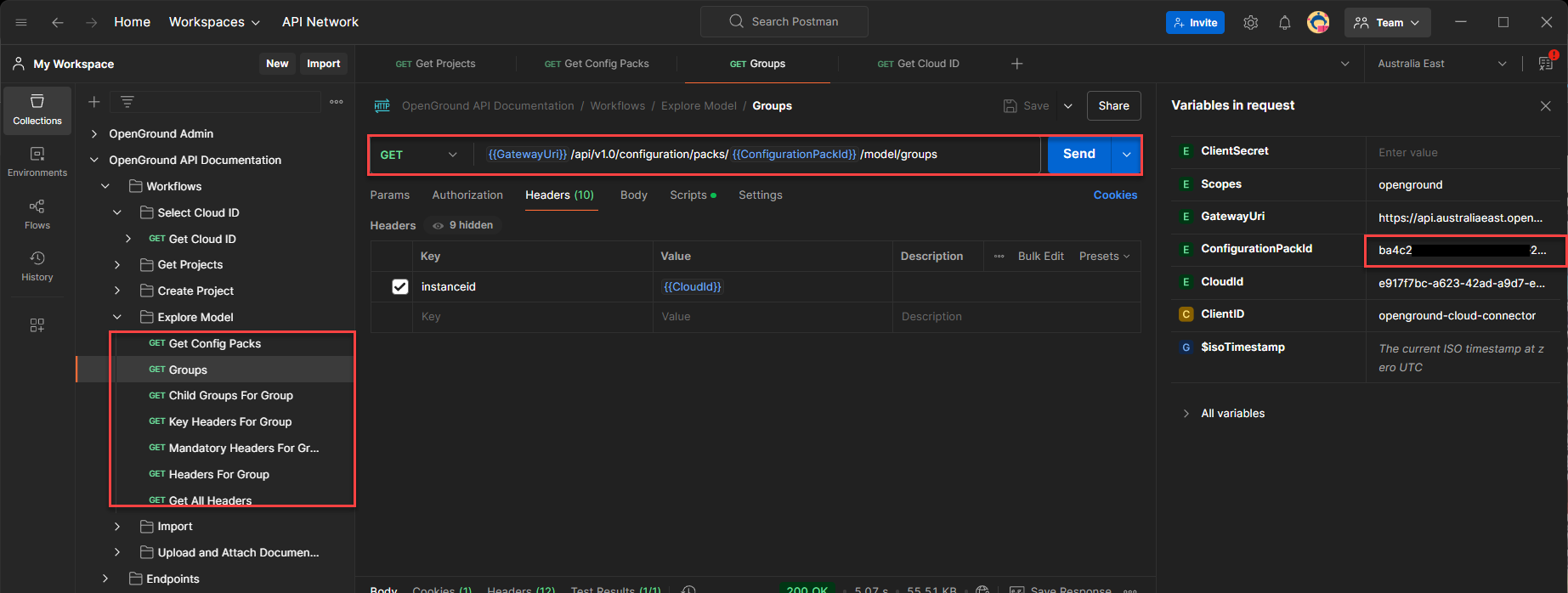

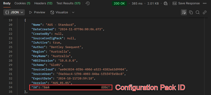

Before you can return information about the data model you first need to decide which configuration pack you want to query. The “Get Config Packs” query will return a list of configuration packs on your selected cloud.
Get Config Packs Query
API Response
Your API response should look something like the below. Take note of the configuration pack ID of the configuration pack your interested in as you’ll need this to further query your data model.

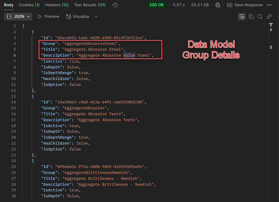

Return Data Model Groups
Notice in this query, we are using the “{{ConfigurationPackId}}” within this query which was obtained from the previous GET response. This directs your query to the configuration pack of interest.
API Response
Other Explore Model Queries
Within this example you’ll also see additional queries that you can use to return other parts of the data model.

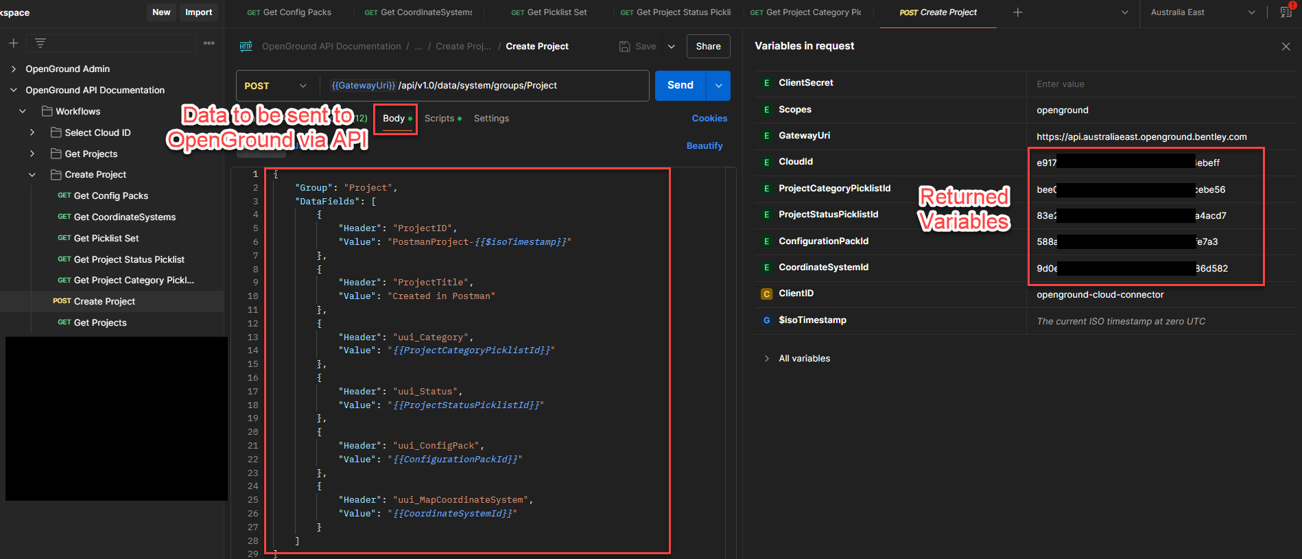

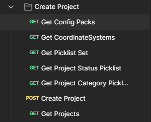

In this example, you’ll learn how to use the API to create a project on your OpenGround Cloud instance.
Prerequisites

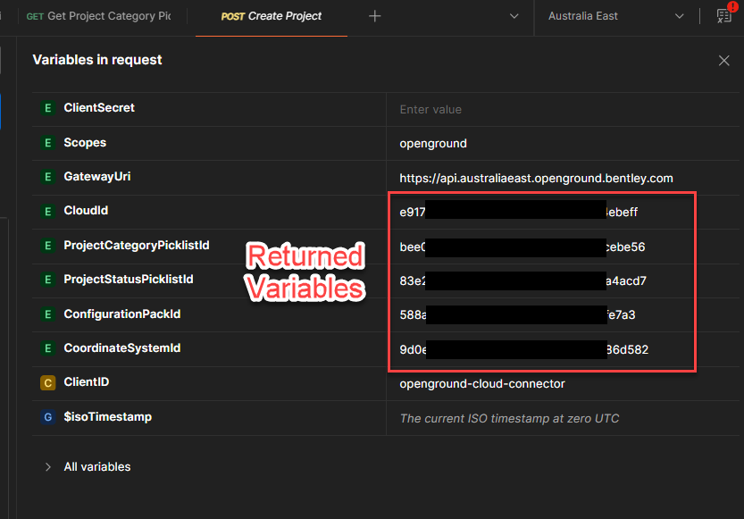

The minimum amount of information required to create a project is defined below. Some of this will be defined by the user during the creation process, others fields such as picklists will require the user to use an API to return picklist information so we can fill these fields out. It may be helpful to first understand project creation workflow in OpenGround Professional before attempting this directly through the API. Mandatory fields required are listed below
The GET requests in this workflow has been defined sequentially to return the mandatory information.
Running these requests will return information to be automatically stored within your environment variables.

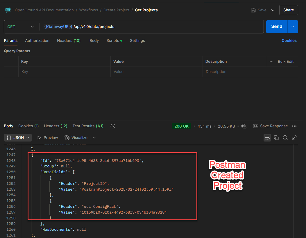

You can now use the “POST” request, to pass information back to OpenGround to create our Project. The default example will assume values within the body of the request.
Header: “ProjectID”
Value: “PostmanProject – {{$isoTimestamp}}”
Header: “ProjectTitle”
Value: “Created in Postman”
The data within the value fields within the Body of the request can be changed based on project requirements. Ie Created “Project title” can be altered, by replacing “Created in Postman” with the title of your choice.

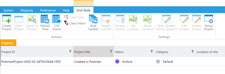

Running the “GET” Projects Query will return all projects on your cloud including the project created with Postman. You will also be able to see this in OpenGround Professional.
