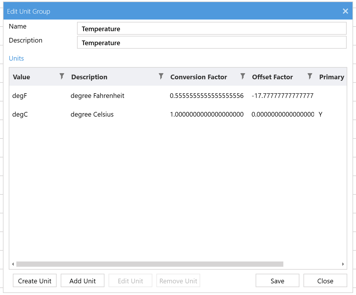

When editing a unit group, to add new units, the following information will need to be provided.
Value - This is the name of the unit. If adding a new unit, add it to the units picklist first by selecting the Create Unit button at the bottom of the window.
Description - This is the description of the unit from the units picklist.
Conversion Factor - This is the value that will be used to work out what the value should be when a different unit is used.
Offset Factor - This is the base number for converting numbers from one to an another. For most units this will be 0, however for unit groups such as temperature, this can vary as the 0 point for both units is different.
Primary - This selects whether the currently selected unit is the primary unit for the group. If this is selected, it is recommended that this is the unit that has the Conversion Factor of 1 and Offset Factor of 0.
Conversion - (shown off screen in the below screenshot) This shows an example of what 1 primary unit will be converted to with this new unit. For example, 1 degC would be 1.799999 degF using the information below.
