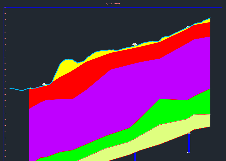

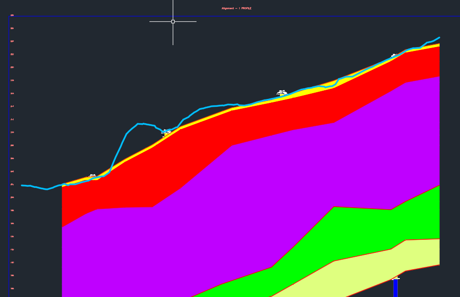

The extension and the Geotechnical Module uses simple triangulation between boreholes to generate surfaces, this means you often see the ground surface intersect the generated geology surfaces.
Below the blue represents the ground surface.
The top surface does not follow the ground surface, in reality it should look more like this:
This tutorial shows how you can tidy up the profiles geology hatches to reflect the ground surface.
Please see the tutorial video below.
