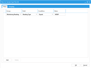

All we need to do now is filter the group by a Reading Type, in this example I'll use 'WDEP'
In Template Studio still, select 'Filter Groups' from the ribbon
Select 'Add' and create a filter group
Click on the filter group you created and then select 'Filters' at the bottom.
In the new window that opens Select 'Add' and create a filter like the one below;
After this press 'ok' and 'ok' again.
