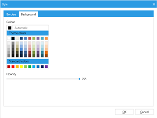

We will then need to edit the style of the bar chart. Browse through to the Appearance tab and select Styles, then select the Background tab. Select the black colour.
