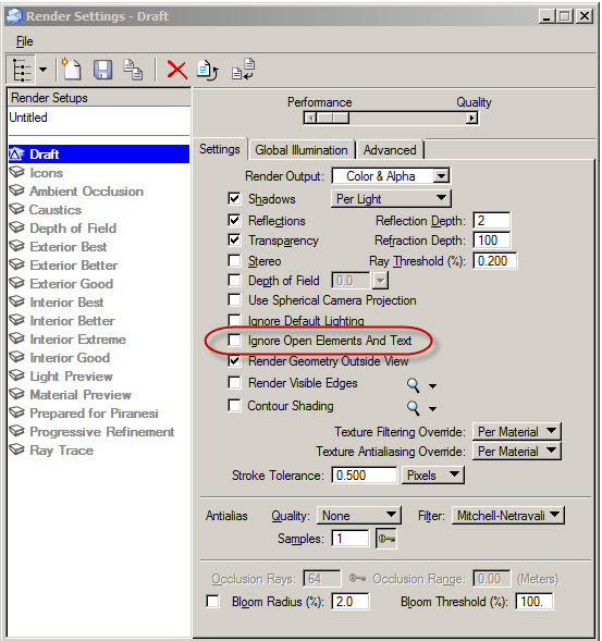

When I render a view containing text and line elements these do not appear in the rendered output.
Steps to Resolve

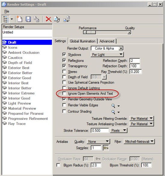

By default open elements lines and text are not displayed in rendered output, but if required can be turned on in the Rendering Settings.
