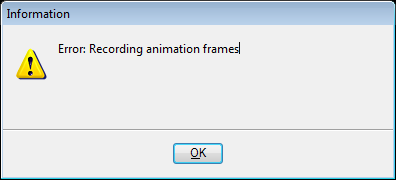

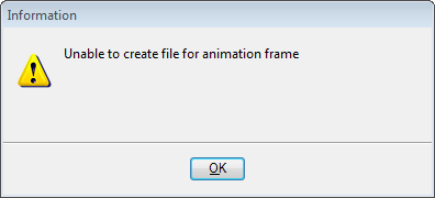

When attempting to record an animation one of the following dialogs appear.
Unable to create file for animation frame
Error: Recording animation frames

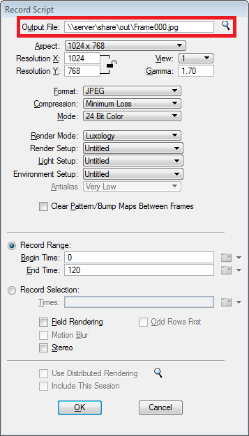

Make sure the computer(s) recording the animation have read/write permissions for the output file directory in the Record Script dialog.
Record Script Dialog - Output File Directory
