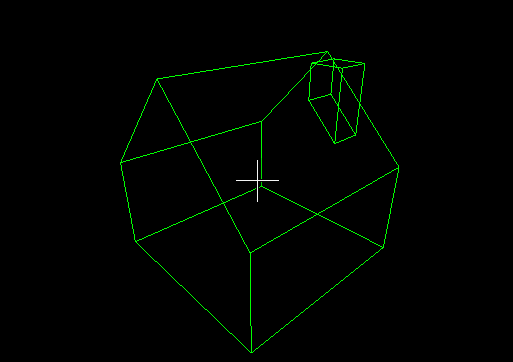

When selecting the Rotate View tool and selecting the Dynamic Method from the tool settings dialog, a large white cross appears showing what point will be used as the center of rotation. By default this point is centered in the view and at the active depth. Keep in mind, it can always be returned to this position with a Fit View.

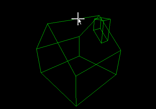

This center mark can be dragged to any location in the model: position cursor over it (it displays thicker), enter a data point to pick it up, and another to move it. Reset cancels the move. AccuSnap works normally to facilitate positioning the center mark.

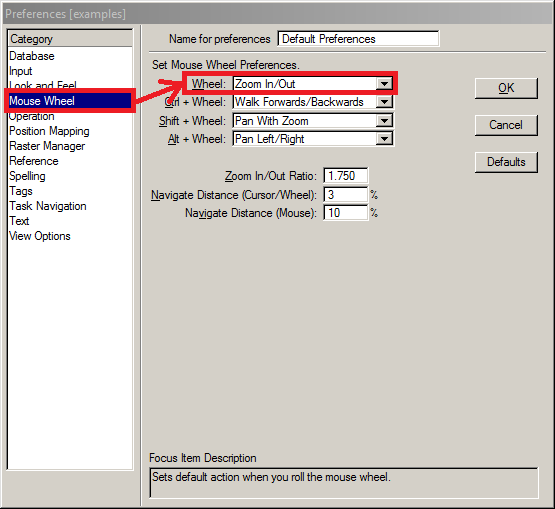

 • The behavior described above assumes the mouse wheel preference is set to Zoom In/Out.
