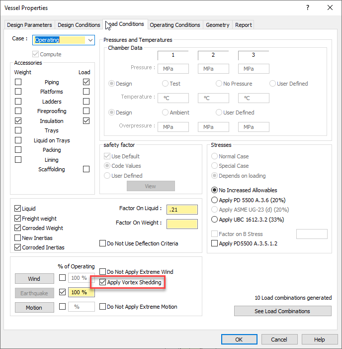

"Bentley AutoPIPE Vessel Design and Calculations has stopped working" message appears when running Strength Calculations on a vessel with Vortex Shedding enabled
Why and how to avoid it?
The vortex shedding is causing the crash.
 Unchecking “Apply Vortex Shedding” will pass the calculation (checked within the “Example with external support.emvd”, not in “Example.emvd”)
Note: the help topic clearly mention that the Vortex Shedding parameters must be defined otherwise the Vortex Shedding is not analyzed.
This has been logged (TFS: 1056735) and will be fixed in a future version of the program.
