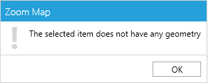

OpenGround returns a selected item does not have any geometry message
Issue Summary
The following message will most typically appear when the 'Zoom on Map' command is used for a location which does not currently have coordinate details currently defined against it:
It is possible to confirm this by reviewing the 'Location Details' grid having first clicked the button to 'Reload Data':
Resolution
To resolve the issue either put the grid into 'Add/Edit Data' mode and key in the coordinates or else highlight the specific location and 'Set Location' to pick off the appropriate point on the map.
Other Workarounds
However, on some rare occasions the data may not have updated correctly, meaning that a 'The selected item does not have any geometry' message will return even for holes which do have coordinates. Under these exceptional circumstances performing a 'CSV Export' and importing the data back into the project ('Data | Import Data') will cause the project to update correctly and allow the locations to be displayed correctly on the map.
